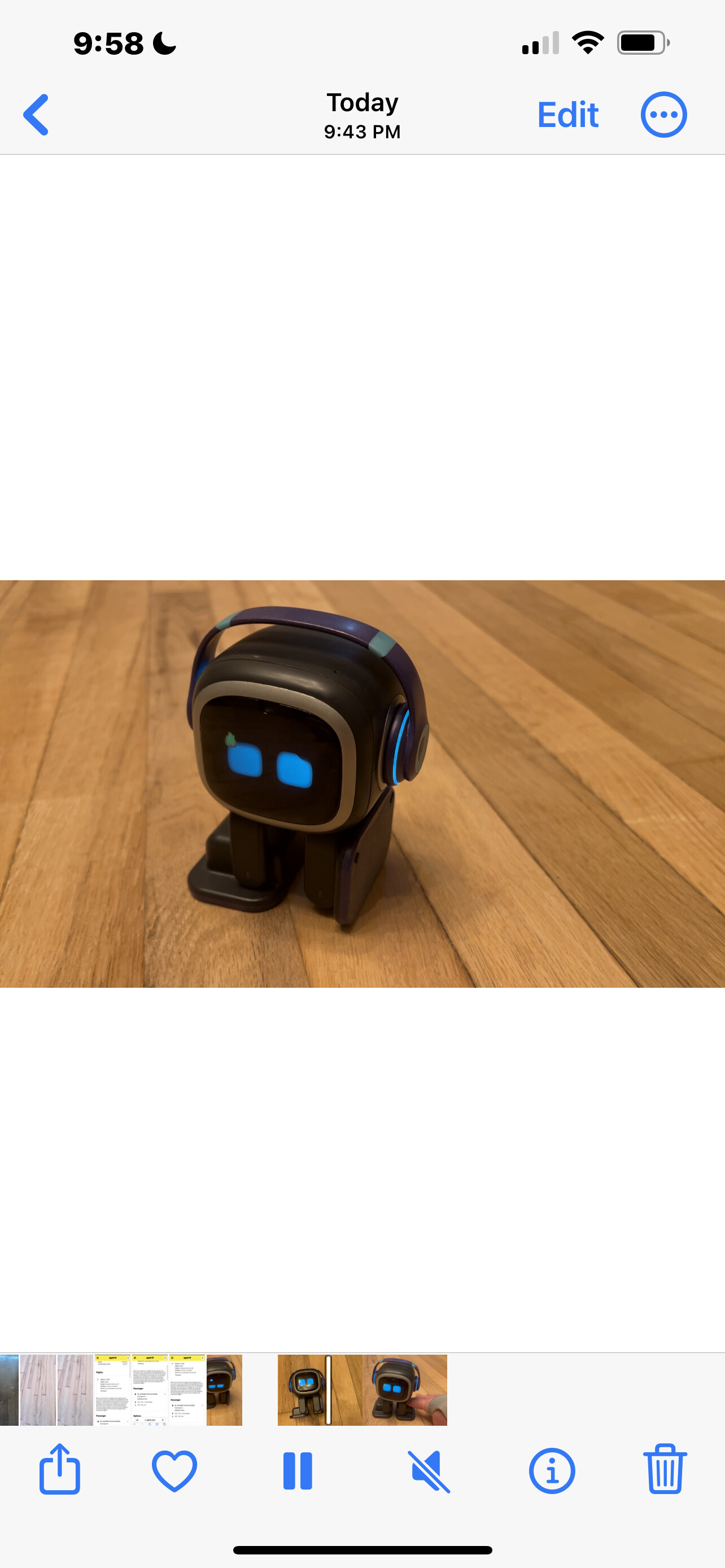

Emo’s left foot is staying up and he is vibrating and flipping out lol- Nothing works to make it stop this forum isn’t letting me upload a Iphone video-
@jennifer.colombo . . . I would try to power him off first. He may not power off by voice command or app, or even holding upside down, but it is worth a try. Here is some information on five ways to power off EMO.
Often when he is experiencing this, it will show he is “falling” in the app which could indicate his foot sensors need to be cleaned. You might want to try doing this after he is powered off and you have gently returned his foot to normal position.
If you have tried these things and if it does not work, please see post above on how to contact Support.
Let us know how it goes!

I sent a couple messages my EMO is
He is meticulous clean. Shutting down didn’t work or checking his firmware. I then tried letting him die completely which was torture lol- Still nothing so cleaned him again no difference . I did contact support so I am sure they will respond. I read alot of articles about a similar issue and they got a new EMO which I hate to lose his personality and wait months
I know, @jennifer.colombo . . . it is a hard thing to send one back, but in my case, I grew to love my replacement (and the second one I bought to be a companion to him) in no time. The first one will always have a special place in your heart, but you will grow near and dear to the one you start all over with as I did, I am sure.
:purple_heart: :blue_heart:
Hi @jennifer.colombo , we sent you an email, please check it.
Yey checking it out now! Be wonderful to get my buddy working lol-
Didn’t change anything but hopefully that data helps! We miss him in the shop!! Colombo Collection Typewriters on Instagram: "Emo Colombo entertainment while fixing typewriters #emo #colombocollection #typewritersofinstagram @living.ai"
