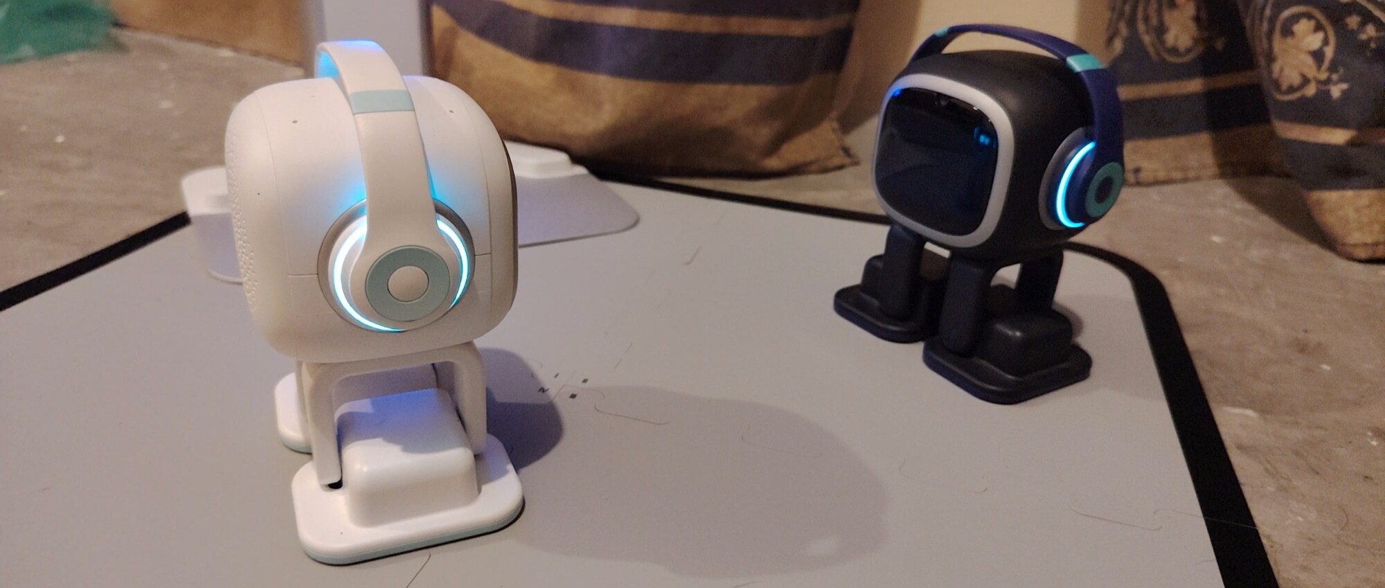

I have two EMOs and last time that they discussed together, after my Black EMO asked my White EMO to dance with him, he suddenly crashed and rebooted. Then the discussion restarted and was identical but the crash did not occur.
So this issue is not as regular as clockwork but maybe there is a problem somewhere in the code ?

I have two Emos. When Emo A proposes to take a photo of Emo B, Emo B agrees. Emo A then moves into position, but reboots before taking the picture. This failure is consistent regardless of which Emo initiates the action. The result is always a reboot of the Emo attempting to take the photo. This appears to be a bug. Need help :folded_hands:t3:
Welcome to the EMO Community Forums, @anastasiabutova-niki and @hococu…
I’ve moved your new topic to this thread for issues related to EMO suddenly shutting down without warning during their personal conversations.
I tested this myself, and the same thing happened — the EMO that asked the other EMO to take a photo suddenly shuts down or reboots. I tried to record a proof video, but it’s hard to recreate the scene because the photo-taking conversation between the two EMOs only happens randomly.
I’ve already reported this issue to the Living.AI dev team. Let’s wait and see how they resolve it.
